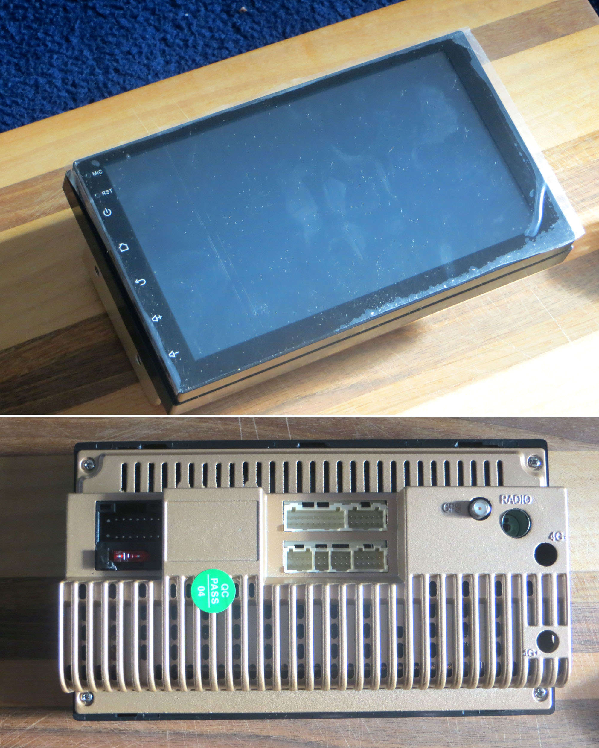

I got this Panlelo S6 car radio.
Built-in microphone is not so good. I can hear well others people during bluetooth call, but they can't hear me very good, especially at high speeds.
I would have connected external mic, to fix my problem but device does not support it, no input for that.
Does anybody have any idea is it possible to connect it somehow external mic?
Or some other way to fix this?
Thank you.
