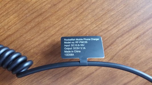

Nice 3 amp charger. I wish my 2 USB port charger would support 2 amp on both ports at the same time but mine shares the 2 amps between both ports. If I plug one item in I have a full 2 amps available, if I plug a second in it has to share the current between the two devices.
How long ago did you buy it. I checked the reviews on Best Buy and pretty much all of them say that it comes apart after couple of month.
I've had it for about a month now and have used it daily until a few days ago when I purchased the spare battery charger. No problems so far.

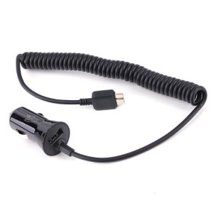

I a haven't found any car charger that can rapid charge as fast as the OEM USB 3.0 charger that comes with the phone. I've tried this one that is supposed to but it contrary to the description only charges in USB mode and is worse than the above and essentially worthless:
Amazon.com: 5V 2A Mini Car Charger + Coiled Micro USB 3.0 Cable for Samsung Galaxy Note 3 III SM-N9005 - Black: Cell Phones & Accessories
