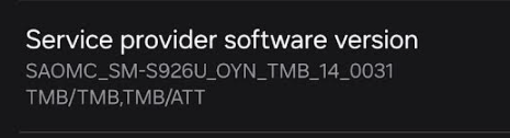

My daughter's S24 Plus, originally with AT&T, we ported her phone to T-Mobile, for some reason, this is the only phone that has not received One UI 7. Any idea why?

What does it say on Service provider software version, can you go to about phone in settings take a screenshot of Service provider software.

AT&T branded phones, even if unlocked after-the-fact, still only get their updates while on the AT&T network.
No way around that. No amount of "CSC" changing with SamFW or whatever will change that. T-Mobile can't help either.
If you want updates, any updates including security updates, you will have to learn how to flash it yourself with Odin. There are folks on this forum who can help with that.
