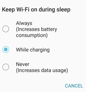

However I'm attaching screen shot of this option to only have wifi on when charging (when phone sleeps) Would this then hurt battery because it's searching for network which is weak?
Remembered this was frustration part of my experience last time when I was at home.

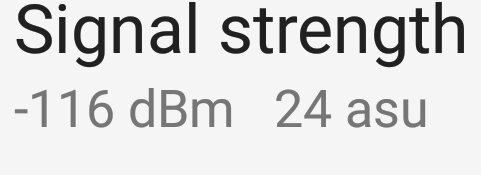

My signal strength is attached. Been that way on my Note 5 and now Note 7.
My iPhone was better.
I don't get it.
My iphone pulled in signal, wifi and cell, where no other phone could. Comparing to an S6, note 4 and 5. No service on them whatsoever while my iphone had a solid signal. I'm hoping the note 7 is at least as good.
I don't get it.
OK... so 116 dBm on one of your phones. which one? what is the signal strength on your new Note and what is it on your other phones? As others mentioned, ignore bars.
