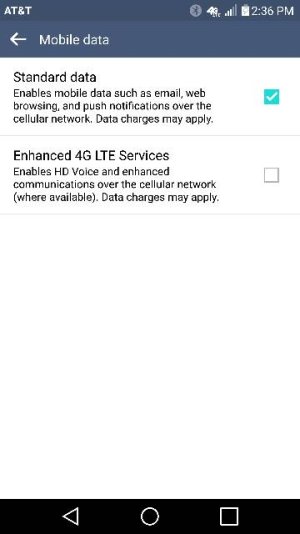

I also had this issue. Cell standby and phone were taking lots of battery according to the chart. Actual battery didnt seem too bad though. I turned off enhanced LTE (for HD voice) and it doesn't show up anymore.
Settings. Data manager. Options. Mobile data.
