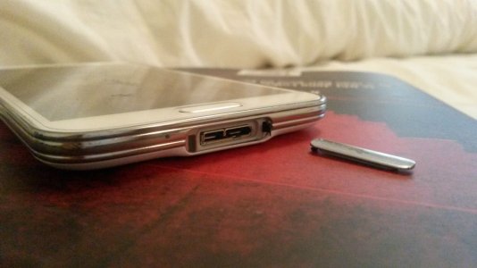

Yes, I've had mine less than 2 weeks. I've only had to charge it a handful of times, and the cover popped off over the weekend. I tried to re-attach it and it won't attach again. I haven't been rough with this phone at all. In fact, I don't like the phone very much at all so I've been avoiding using it.
Mine broke off today just like the photo attached. I'm afraid that it is no longer water proof.

Push the cover back in firmly and it should hold without the attachment link. That link is only necessary so you don't lose the cover when opening it to charge.
When the link is attached, it should not be twisted up or down. It should be in a parallel position to the side of the plug without tension. Twisting the link up or down will break it.

I seem to have a different problem. This is my second s5. The first one was faulty. This one appears to be fine however the charging flap doesn't securely close. The slightest pressure at the opposite end and it pops open. The tiny little hook on the inside of the flap doesn't seem to be holding firm. I know it's not right because it was very firm on my previous s5.
Any one else have this problem or am I the unluckiest s5 owner going
Same issue. The little hook that latches the cover into place was peeling off from the base of the cover.
What I did was put a tiny dot of superglue at the bottom of the hook (that is attached to the cover) to prevent it from wiggling out of place.
Now the little rubber hook is firmly in place and won't budge.
Sounds like your hook is having the same issue. See if the hook is wiggling when you touch it. If it is, secure it with glue. If not, you could be having a different issue.
I know it's stupid to have to bust out super glue to a brand new phone...but it does work, very well. Good luck.
