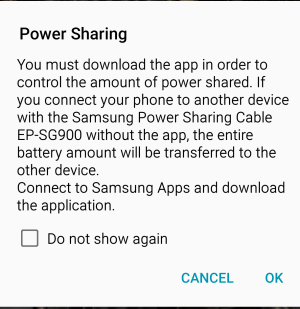

Was wondering if anyone is having problems when charging their Note 5(Verizon)? Everything was working fine, then 2 nights ago, it suddenly started acting weird. I tried 2 different cables, and all it does is make that sound when you connect the cable. Only way to actually charge device is to shut it off... Also this weird popup started at the same time.. Screenshot included...
Power Sharing is the ability of the phone to charge up another device by connecting it via USB cable, and using the Power Sharing app. In your situation, I wonder if there's an issue with the USB cable you're using, or perhaps the phone's microUSB port. Make sure the port is clear of debris; if that doesn't help, then try a different USB cable.
