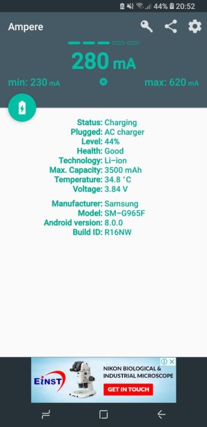

Attach is what they are showing.
I am using Tronsmart 5 port 90W charger with Baseus 3A cable
That temp is starting to get warm. Not dangerous, but maybe warm enough for the OS to start throttling the charge rates (I know LG is bad about that). What's the temp like when using the other cable? Also, slow charging performance is a sign of a cable going bad, due to weak connections inside it. So I wouldn't rule that possibility out too.
