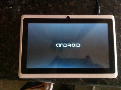

image.jpg i have the mid 4.0.4 and it keep getting stuck on the android as sow in pick. how can i get firmware to re flash it ?
