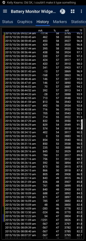

I saw the choetech fast wireless charging article on Android Central and wanted to give it a try
http://www.androidcentral.com/choetechs-fast-wireless-charger-effective-and-affordable
Physically it looks fine, it lights green when connected to a quick charge 2.0 charger, otherwise it will light blue. The charging pad is slightly wider than the note 5. It has a anti slip ring, so it shouldn't slide around even when going bare back.
It was pretty easy to use and charge, and the phone does have a notification for fast wireless charging.
With the screen off, it charged at an equivalent 5v,1.7a for a short while, then went back to 5v,1a equivalent charging, and tapers off at around 90%
With the screen on, it charges slow below 5v,1a, and as it gets warm, charging starts to trickle. I wouldn't recommend usage with the screen on while using the choetech fast wireless charger.
