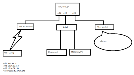

Here is a sketch of my network:
eth0 Internet IP
eth1 10.20.30.253
eth2 10.20.31.253
Chromecast 10.20.30.143
So chromecast device is connected to my LAN, and has the IP address 10.20.30.143. I can ping this IP address from my wifi laptop, meaning the routing of ICMP packets do work throught the chain.
