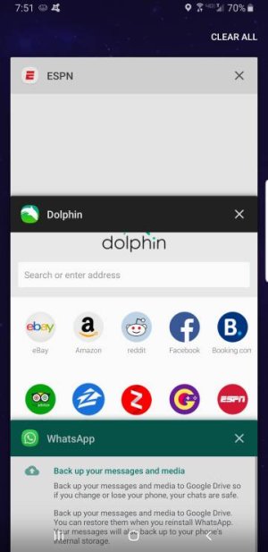

My wife and I have Note 8 phones under Verizon. Both phones got upgraded to pie recently. When I touch the app switcher button, I see the open apps, with a "close all" option at the top of the screen. But on my wife's phone, the "close all" is on the left side of the screen. What would cause the difference? 35447.jpg

My wife and I have Note 8 phones under Verizon. Both phones got upgraded to pie recently. When I touch the app switcher button, I see the open apps, with a "close all" option at the top of the screen. But on my wife's phone, the "close all" is on the left side of the screen. What would cause the difference? View attachment 302135

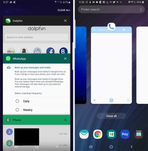

Here is what both app-switcher screens look like (mines on the left - hers is on the right).

I did find one difference, however. For the "home screen" settings, my phone only has one item listed: "Nova Launcher" (and it's selected). Her phone has both "Nova Launcher" and "Samsung Experience Home" (and Nova is selected).
I did a Google search of "Samsung Experience Home" and in Google Play, it indicates the app is compatible with "some" of my devices. There's a checkmark next to my wife's phone, but an "x" next to mine.
I have a program called "BK Manager" which can block bloatware and other programs, and "Samsung Experience Home" was being blocked. I unblocked it, and even though it's not selected as the home screen, I now see some other screens correctly now.

Since you disabled Samsung experience or now one ui it defaulted to the oreo style recent apps on yours, makes sense
