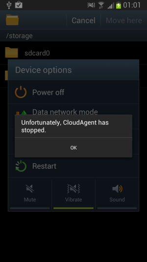

CloudAgent has stopped
bruno.braga
Oct 10, 2012
15
I am getting this message every one in a while, and I just got my new Galaxy Note II out of the box today... Any ideas of what could be the problem?
I could not find anything on the web on that, so I decided to write here.
Thanks in advance,

I am also developer, and thought about that, but from a user's perspective, it was pretty disappointing to see crashes on a just-out-of-the-box phone, on which I have done nearly anything yet... and CloudAgent is a Google/Samsumg service running in background... This should NEVER happen, right?
Anyway, since the problem does not occur al the time, I will leave the logcat on for a while, with hope we can see the stack trace of this specific error.

Both my wife and I bought a Note 2 last week, and had exactly the same problem out of the box!
The Dutch Samsung Mobile Helpdesk couldn't help me by phone and referred me to local Samsung Service Centers. They hadn't even seen a Note 2 before or heard , but were sure factory resets would fix everything. Obviously, that didn't work.
I think CloudAgent is an application that checks social networks like Facebook, Instagram and cloud apps as Dropbox for pictures, but I have no foundation for that. I don't use Instagram, I turned off "Sync Gallery" in the Facebook settings, but I did turn on "Camera Upload" Dropbox, as did my wife.
I?ve got the same problem. Just bought a new Samsung Galaxy Note 2 (excellent device) a couple of days ago, and while setting it up I (apparently) signed up with Dropbox cloud account with automatic sync to the Samsung Galaxy Note 2 (SGN2) gallery app. So now, whenever I open the gallery app it crashes almost immediately, trying to sync with my Dropbox.. So far I have no idea how to get rid of this nuisance..
Me too,
most days since I opened the box - 10 days ago.
I use dropbox too.

I am getting the problem with increasingly frequently. I believe the service is what handles push notifications and anything else that syncs with Samsung cloud. I find that when I get a series of these crashes when I restart my phone I immediately get a notification from a particular app so believe that app's push notification may be causing some of the issue.

I'm having the same issue with my Note 2. This is the only complaint I have with this wonderful device. I'm pretty sure is related to the Dropbox gallery sync. The message usually appears while browsing photos.
I get the same message on my Galaxy Tab 2 Note 10.1 running Android 4.1.1
It occurs only when I am browsing photos which I had downloaded from Dropbox.
Its very frustrating. Hope that there is a fix soon!
I've been experiencing this crash/error too. Given:
- Cloud is mentioned RIGHT THERE in the error itself
- that the problem stops if I disable Photo and Video Sync in /Settings/Cloud
the issue is likely to do with Dropbox or Samsung's implementation of the Dropbox API.

  1. Go to Settings - Personal - Cloud, make sure the bottom two options are turned OFF;
  2. Install QuickPic via Play Store;
  3. Go to Settings - Application Manager - All - Gallery and click "Force Stop" and then "Disable"
  4. Use QuickPic and never use or even mention Gallery again.

Guys, easiest way to solve this problem is justby disabling cloudagent from setting- more- application manager- all- cloud agent - disable...
I just purchased s4 two days ago and this problem is surely annoying
