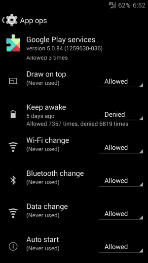

For me using privacy guard to limit Google Play Services from keeping the device awake and also waking up the device worked. After a reboot the device would go to sleep normally. I did try re-flashing gapps but it didn't seem to help. This problem appeared completely out of no where after using CM11 without issue for weeks even after rebooting the phone. It just suddenly wouldn't go to sleep one day while I was at work.

Try "AppOps" from play store. Give root permission and Deny "Location access" for Google play services and Google search app. Try this app with all ur installed apps denying whatever options u dosent need. Install "HOLO Launcher" make it as "system app" using "link2sd" app uninstall "CM 11 Default launcher" reboot. Enable developer options and set animation scale all 3 to "zero".
