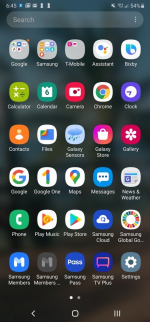

Ok I uninstalled the apps, one by one. I think I only have the basics installed now. I will try to attach a screenshot. The only apps not shown that are on page 2 of the apps is TIPS and YOUTUBE
Im open for suggestion. Even after powering down and reboot, as it is now it still has the error
