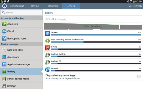

Hello!
I was wondering if anybody know what this processes is? It seems to drain allot of battery from time to time.
Now it's using 22% sometimes it is using 40%.
Anybody have any idea what this this is?
Also another thing, when i am only using S note it is draining 8-10% battery every hour is this normal?
Thanks!

I don't own an samsung tablets, so take my word with a grain of salt, but I'm guessing it may be to do with the S search (where you hover the S-pen over the screen and you'll have an option to search your device. Try disabling that (if you can) to see if it makes any difference.
It have nothing to do with S search, its indexing service and if importing/open/close alot of files many times. If have alot files ex mp3/pdf, and indexing service will drains the battery fast.
For S Note, I run it with no screen time and continuos writing during meeting, also multi screen folder, gmail, S note switching in between, normally it drain about 10 - 12% per hour.
So... you are not alone.
