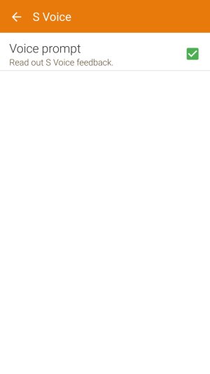

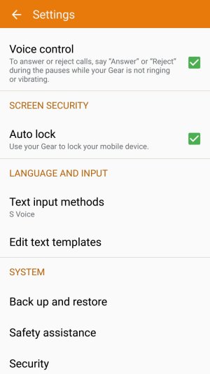

I have the Neo and a Note 4. You should be able to click on the settings icon under my apps. I'm attaching a couple of screenshots from mine. Hope it helps.
Sent from my SM-N910V using Tapatalk
