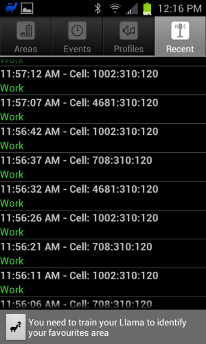

Okay, more info for the signal strength hypothesis. I run Llama which sets profiles by where you're located. It uses cell numbers to figure out where it is and there's a "Recent" tab that shows the last several cells and when the phone "attaches" to them. I was in a room in the middle of the building at work where signal strength is notoriously bad (for Sprint, anyway) and I felt the haptic buzz of the context menu getting triggered. I pulled out my phone and quickly opened up that Llama Recent tab and it showed several cell changes while it was buzzing the context menu button. So maybe it's not *just* low signal but switching between low-signal cells.
I would agree with the above observation based on my experience. The trigger isn't necessarily when the phone is in a low or no signal state, but rather when it transitions between two low signal states. It could be something about being on the border of low and no signal, somewhere between low and roaming.
