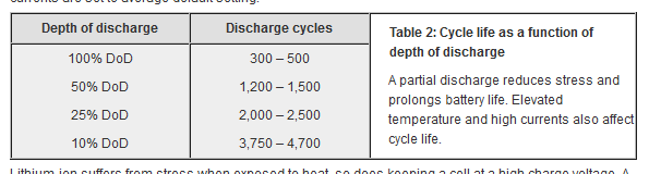

With earlier battery technologies, it was suggested that you bring the battery close to empty (10-15%) prior to recharging due to the battery's "memory" effect. That rule does not apply to modern Li-Ion batteries. I found this interesting chart, here How to Prolong Lithium-based Batteries - Battery University :
Notice the huge drop off in potential battery discharge cycles when the battery is allowed to fully discharge (100%) between cycles. Clearly, recharging at 50% empty is better than at 100% empty; the question is, where along the line between 50% empty and 100% empty is optimal?
