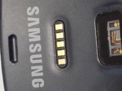

Over on XDA someone posted that their charging contacts are corroding and the Gear S is no longer charging. I checked, and mine are corroding away as well! Could you all check and report back on your findings? This is kind of crazy!image.jpg
Mine's got the same problem.
If I start having charging problems I'll just try giving the contacts a tinning of silver solder.

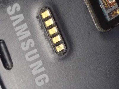

Update: I gave the area a thorough cleaning and inspection under a 30x microscope. The good news is that it looks like there's a nice solid chunk of copper under the gold plating. So it's likely that a good cleaning and maybe some light abrasion with a stiff eraser should be sufficient to correct any contact problems. If this had just been a thin circuit board contact wearing through, getting the surface tinned or protected against degrading further would be much more critical. The cause of the pitting was likely minor defects in the gold plating which allowed sweat to get to the copper underneath.
Here's another photo after cleaning.

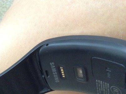

Im having the exact same problem, my gear 2 is not charging anymore, a few weeks prior to not charging, I was feeling a little rash when I was using my gear 2, i took it off and saw I had 2 little red spots in my wrist, i looked at the back of the watch and 2 of the charging pins were corroded , few weeks later one of the charging pins is gone, and my watch is not charging at all, still under warranty, any chance samsung will honor this, i have heard stories about them saying is physical damage, this is clearly a manufacturing defect, because a lot of people are getting this problem.

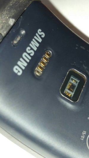

I have the Same problem with my Gear S. It won't charge anymore so I just powered it down. The Battery Contacts on the watch the one on the far end is gone the rest of them are still there but pale looking.
DO you know any shop that could fix it and how much. The Sweating on these Hot California Days just killed the Contacts to corrosion.

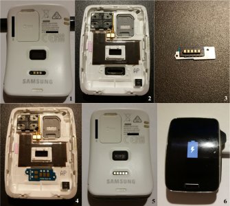

So, same old corrosion problem here. Samsung Israel said the contacts corrosion is not under warranty. Referred them here, told them I'm not the only one with this problem, they said as long as Samsung does not declare this as a bug they will not fix it. They were willing to sell me a refurbished watch for ~$240... Didn't happen.
Due to the fact Samsung's warranty is useless I decided to fix it myself.
First I tried to re-solder the contacts (1), no success here.
I then opened the watch using a hot air blower (there are several video guides on YouTube).
I found out the contacts are part of a small PCB connected to the back side of the watch. I'd removed it (2) and went online to find a replacement (Search for "sm-r750 charging connector" on eBay).
I ended up ordering 2 PCBs for $6.74 each including shipping to Israel. (We know it will corrode again...)
It arrived today. As you can see, there's a small white plastic you need to peel off from the adhesive (3).
Peeled it off and put it in place (4+5).
Closed the watch and connected it to the charging cradle (6).
Success! It's alive!
