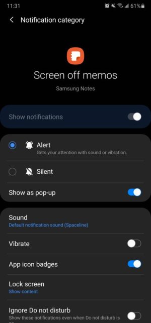

I just went into "Settings">"Apps">"Samsung Notes" and enabled "Notifications" BUT it looks like "Screen Off Memo" is grayed out so it can't be selected as a choice (even though it appears to be on) - I came back out and refreshed everything, did a test screen note and, you guessed it, no notification still??? Sorry, it was worth a shot! Typical Android cryptic weirdness!
Tap on the words and it will take u to another menu , toggle on pop upsScreenshot_20200922-113128_Settings.jpeg
Still no notification on my Note 10+ nor my Note 20 Ultra.
Same. Thanks for the above suggestions, but I'd already found and set those things. I'm still not getting the notifications. I guess it's as bbgpsuser says, the application is just broken. I have to say that between the lack of a notification LED and now this, it's tempting to go back to my Note 9. Pretty disappointing when they can't get stuff like this right.
Yes, I know about AOD, etc. It's just not the same.
Yeah its broken , must be a bug
Yep, I just went back in and specifically selected (General Notifications was already "ON") "Screen Off Memo" On, then for that, selected "Screen Pop-up" On, selected "Sound" on, selected "Ignore DND" and saved! Tried a Screen Off Memo and NOTHING!!! I reset everything back to off... not sure what is the problem, but OP is right!
Its probably a bug , I tried uninstalling the update to the notes app but still same results.
There was an update on Samsung Notes yesterday. Description said it fixed some bugs, so I was hopeful. But the subject bug persists even after the update. Disappointing.
