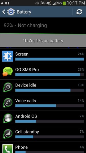

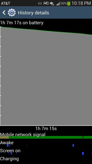

I have been having a problem with my S4 for a week. The battery seems to drain at a crazy rate for no reason. I charge it to 100%, go to sleep for 7-8 hours and the battery is at ~40%. I didn't even use it, I'm not sure what to do. I did a factory reset and the problem still persists. The only thing I have on is my mobile data and thats it. I attached two screen shots showing the drain from about an hour of idle.
What should I do?

The attached pictures just show battery drain over an hour. It looks like you spent a little time texting and that's what drained the battery there. Something is waking your phone up every half hour or so and who knows what that might be. It's hard to tell what could be draining your battery overnight with the information given.
