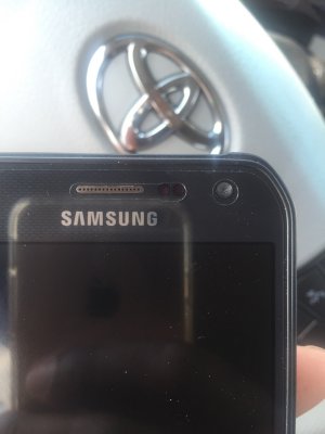

I currently own a Galaxy S6 Active that malfunctioned after being exposed to water (Splash Park for kids with sprinklers). After about 10 minutes at the park while taking some photos, the screen blacked out momentarily and the device reset. About 15 minutes later, a fog and beads of water were visible inside the front facing camera lens. The screen remained non responsive for several hours and improved only after I placed it in a dehumidified basement. The screen functions fine now, however, the physical back button has stopped functioning properly. I have filed a ticket with Samsung customer support.

I contacted AT&T support and inquired about my device being covered under the exchange program. I explained that my device malfunctioned after being exposed to water. The support specialist ran some remote diagnostics which revealed the back button is malfunctioning. However, I wanted it to be perfectly clear that I think that this issue is related to water. The specialist processed the warranty exchange, but also stated that if the device is determined to be damaged due to water, that I will be charged for the replacement $616.00. A new device is on the way. She also suggested that I go to a ATT store so they can determine if the device is in fact damaged due to water. I guess there is a physical examination they can do in the sim card tray.
I know for a fact that water got inside because of the water beads in the lens. Its definitely a Samsung issue, but they drag their feet on support and replacement turn around times.
I'll get the device checked at my local ATT store and see what they say.
So the associate looked up the indicator location which is in the SIM tray and advised me that the LDI was not tripped. I asked him to show and explain it to me, and it is still white. If water had contacted the strip, it would be purple or pink.
I accept that's all he can do, as he is not qualified to physically open the device for further examination. I know for a fact water was somewhere in the device because of this photo. I want to be 100% sure what is causing this issue and it is properly resolved.
