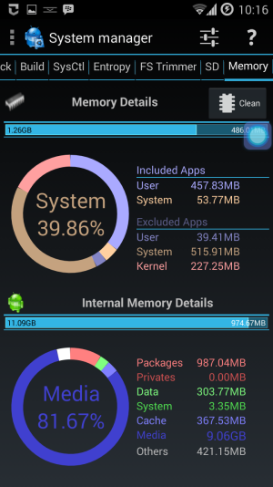

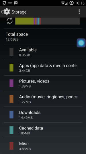

I have been combing through this site and other sites trying to find a solution but to no avail. I recently flashed cm11 the latest nightly on my GS3 2 days ago (12-03-2014) and i noticed that now I only have 0.95gb available even though I reinstalled a few games and apps it shouldn't have been that much. I checked my root folders and could not find what was taking up so much memory, I however used Android Tuner and checked the memory consumption and see where its recorded that I have over 9 gigs of media which is crazy. Any help or solutions would be greatly appreciated. Not sure if when the next nightly is released it will fix the problem.

Thank you! I added an extra step though, what I did was reboot it in recovery mode, then do a factory wipe and reset. I rebooted after but I still had the problem so I rebooted into recovery again, did a backup to my external SD card, and did a wipe of Data/Media then I restored the backup and I got back my memory!
