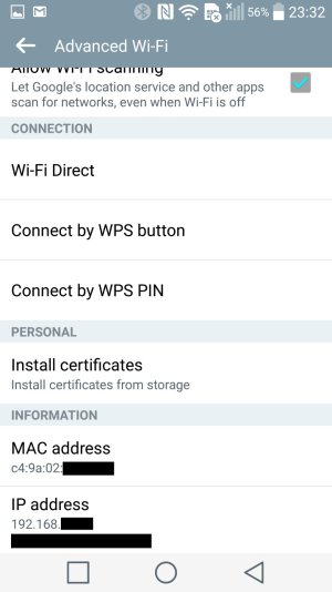

Hi,
I have a really weird issue with my brand new G3.
I started configuring the device without a SIM, and it saw my 5G (802.11AC) home network (Netgear R7000 router).
I was working with this connection and everything was great. I done all my software updates (maybe 8 of them) from the initial store 4.4.2 to 5.0.
The phone now say that I have the latest version.

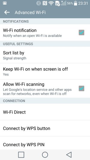

When I inserted my SIM card the phone stopped discovering ("seeing") the 5G WIFI network, it now sees only my 2.4G network.no matter what I've done, it wont discover the network it worked with before the SIM insertion and start up.
I also recall that I had more settings in my Advanced WIFI screen, and at least 2 settings which I remember are now missing. One if the setting which switches to cellular DATA when the WIFI signal is weak, and the other when the WIFI network doesn't have an internet connection. There might be more settings which I'm now missing, but I recall these two to now be missing from the Advanced WIFI screen.
Taking the SIM card out doesn't solve this.
The only way I've managed to restore the 5G connectivity is by doing a factory reset. BUT, inserted the SIM card ruins it again!
Does anyone have an idea what could be affecting this?
Thanks,
Tom
The attached pictures shows how it looks when it's connected to the 2.4G network, and the missing settings:
Re: LG G3 D855 stops discovering 5G WIFI when inserting a SIM
Hi Tom! Let's see if we can get you back up and running.
Make sure you have the proper APNs setup for your carrier. That's what the SIM will need to see the network. On the WiFi, be sure to reset the router and see if it connects. Unplug it for a minute or so and reconnect it. See if that helps restore the WiFi network to your device.
Hello Magnus,
This router has been serving clients through the 5G network for around a year and without a hitch.
The problem started when I tried using a SIM in the G3.
With the phone freshly factory reset and without a SIM it works with the 5G network without a hitch.
Anyway, I have tried rebooting the router and it has not changed the issue.
