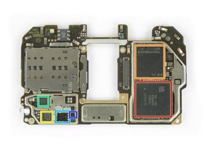

The SoC (System on a Chip), loosely similar to a CPU in a desktop/laptop, and the internal storage chip are separate so it's not a matter where their interchangeable or equal to each other. They are two distinct components, but in a smartphone both are soldered directly onto the logic board so essentially it's the logic board that is one unique item. This photo is a Hauwei Mate 10 Pro logic board, taken from the iFixit.com site (see step 12):
https://www.ifixit.com/Teardown/Huawei+Mate+10+Pro+Teardown/100096
The chip highlighted in red is the SoC (processors), the chip highlighted in orange is the NAND storage (internal storage).
Replacing one or the other is doable but you'll have to pay up a lot of money (hundreds if not thousands) because it's a very intricate process to de-solder a failed component off of a logic board, and solder in a replacement. Damaging the board and/or surrounding components is a likely occurrence. Specialized tools and equipment, and trained skills are a must. Most service shops will just replace the logic board entirely, it's a big job just tearing down a phone to do that.
