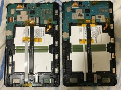

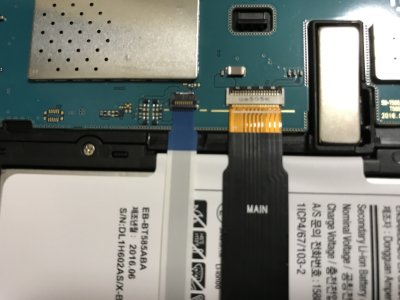

This is the common problem of Tab A 10.1, Wifi or LTE : loose LCD cable. Remove the back cover and remove the tape cover the LCD connector, look closely you will see the line on LCD cable is under the line on mainboard a little bit, indicates it't not fully seated.
Lift the black tab up then push the LCD cable all the way in. Be careful with this plastic tab, it's easily broken if you don't lift up evenly.
Most people don't know how or find the replacement of LCD connector, the mainboard has to be replaced.
Search youtube video how to do it, it's a simple task to do but most novices will break it with careless or without searching how to open the connector of LCD.
They end up to replace the mainboard due to broken LCD connector.
Don't forget to disconnect battery before reseat the LCD cable. After reseat LCD cable and connect back the battery, you can power on to see it works. Then secure the connector with new tape.
This is how to secure the LCD cable properly in model T580 and P580 (Wifi ), T585, P585 ( LTE )
