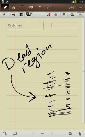

i have a Galaxy Note 8, everything is fine with the device, it has the latest update for my region 4.2.2
the screen works fine with handtouch, however with the S Pen, at some point the screen is unresponsive as appears in the image below.
does anyone, has any clue ??!!
Do you have a case with a magnet, if so remove the case and try again, most work fine, one I bought drove the tablet nuts with lag and dead spots.

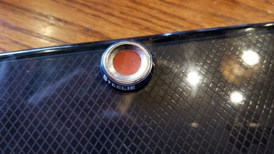

Thank you! I found a dead pen area too. Found this and sure enough I have a mounting magnet on back of case.
Since I never really use the s pen except to goof off its a non issue for me.
Thank you for this!

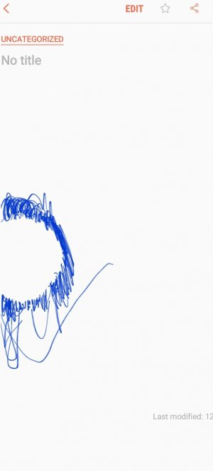

Shots of dead area and magnet.
