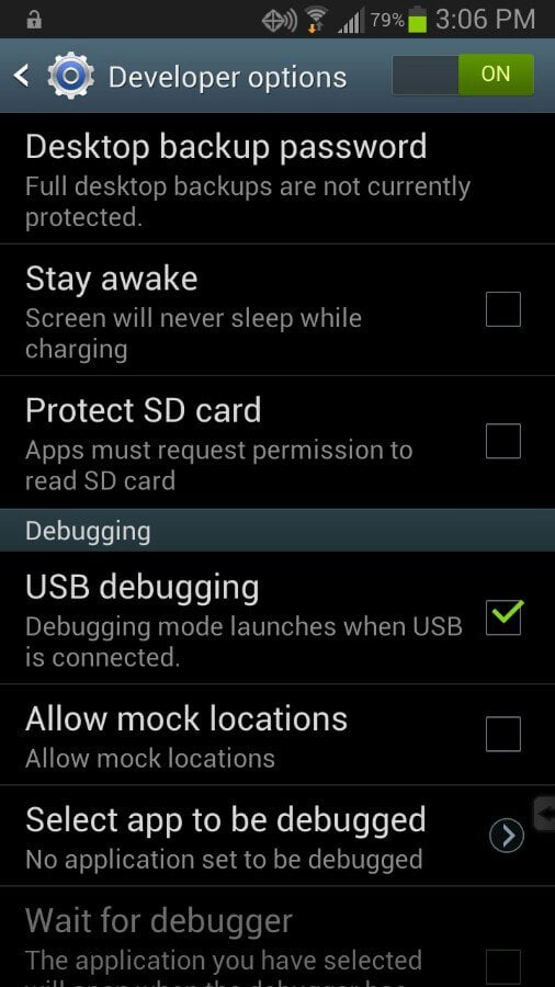

I'm not sure what you mean by the "Device Options" menu - are you referring to the Developer options screen?
If not, please include a screenshot.

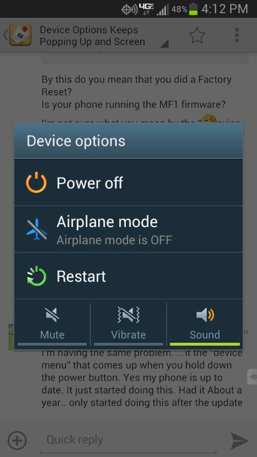

I'm having the same problem. ...it the "device menu" that comes up when you hold down the power button. Yes my phone is up to date. It just started doing this. Had it About a year.. only started doing this after the update
Josh,
So you're seeing this
at random times when your phone is just sitting there? Have you done a Factory Reset since the update? If not, you may want to consider doing one.
