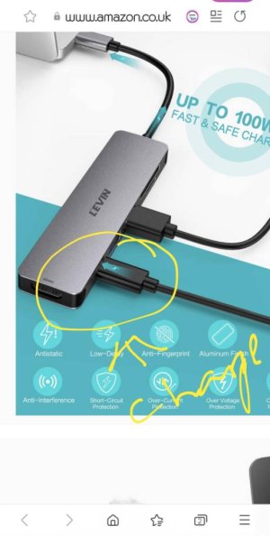

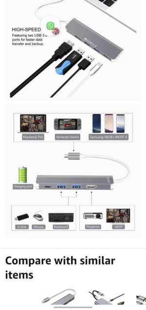

If you check the images in this post it clearly says the USB c port is for charging and it shows the hub connected to power while plugged into a phone for dexScreenshot_20201227-000800_Samsung%20Internet.jpeg
Sorry for the delay in replying. I didn't get an email notification that you replied. As you can see from this image, the pd USB c port is for charging. So you do need to power this hub, like the one I bought. If you power the hub you should be able to use the peripherals. If you still can't it will need returning to amazon and maybe buy the one I linked to in a previous post. Screenshot_20210102-061128_Samsung%20Internet.jpeg
