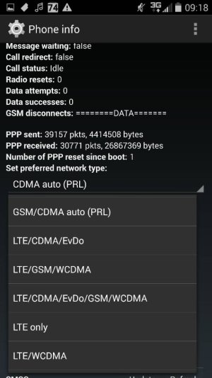

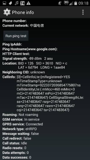

P PeterTheGeek Active member Jan 9, 2015 39 0 0 Nov 25, 2015 #11 There is this app called phone info. And theres more detailed settings. Attachments 1448464462660.jpg 80.3 KB · Views: 8 1448464481881.jpg 58.4 KB · Views: 8
D doogald Trusted Member Jan 3, 2010 4,425 55 0 Nov 25, 2015 #12 Yep, that looks the same as the one I linked above.
