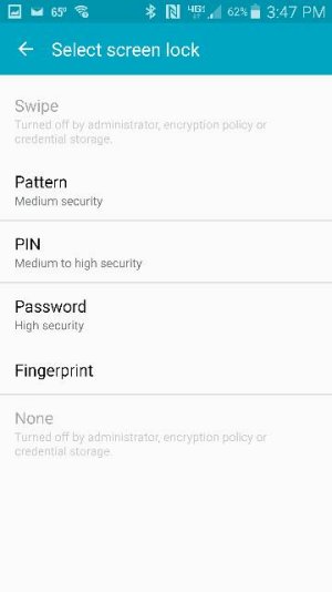

Here's where I'm at. It's still locking
Go to Settings>Security>Device Administrators. Is anything else checked there besides Android Device Manager?

I ended up doing a factory reset. I did lots of research on the subject and it seems I did everything needed without success
