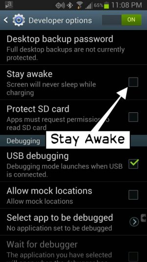

One other option you have...
Under Settings, under "developer options" you can turn on the "Stay Awake" option to make the screen never turn off when plugged in. (You'll want to also make sure Developer Options are enabled). With this enable, once the screen time out is reached it will dim but not shut off -- you can manually turn the screen off using the power button, it just won't turn off automatically when the screen times out.
This would probably be the easiest way to get it to do what you're asking, but you'd have to remember to turn the screen off manually when you're charging the device any other time...

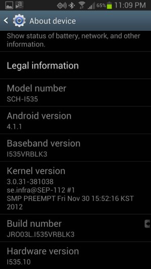

Mine works but it's a Sprint phone, could that be the difference? This is a Verizon forum right?
Sent from my SPH-L710 using Android Central Forums
Yes, this is the Verizon forum, but that option is available on my phone.uploadfromtaptalk1361686982878.jpg
For those that aren't seeing the Stay Awake option - are you running the current firmware?uploadfromtaptalk1361687004381.jpgSent from my rooted, debloated, deodexed Sinclair ZX-80 running CM -0.001 using Tapatalk 2
