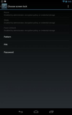

I couldn't find any answer for this so pardon me if it's been answered elsewhere.
I set my N7 to unlock by pin, and but now I want to go back to the slide to unlock. The option under Settings > Security > Screen lock is greyed out. Not sure what I did to disable this option. It says "Disabled by administrator, encryption policy, or credential storage."
Here is a screen cap.
My understanding is you will need to factory reset (and lose everything) to remove the PIN, the only reason I'm not encrypting my phone is that it woon't event let you use a pattern let alone remove security altogether.
It looks like some type of security software is restricting it. Are you running Seekdroid, Lookout, or something similar?
On the screen prior to the one you captured, under Device Administrater, what shows up?

It could be the encryption option, but I didn't think that the encryption would allow pattern lock I thought you had to use either PIN or password for that option.

I'm not running any security apps. I just thought I'd pin lock it in case I lost it. And under Device Administrators it reads "No available device administrators"
In my previous response I assumed you had encrypted your phone, if that is not the case then
I think credential storage can be cleared.

Thankyou, this worked. :-)
