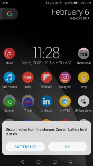

Disconnect from power pop up message- how to get rid of it?

So I did a full FDR to try an fix my issue with not being able to run a few apps.(which fixed my Marriott app not being able to be installed or run!)
Now, for the life of me, cannot find the setting to get rid of the pop up that says disconnected from power. I didn't get that before the FDR. I thought I had read this in one of the forum threads but can't seem to find it. Anyone? Google has not been my friend on this one.

I get it every time and I never did a FDR. It's annoying. You have to clear it before you can do anything else. I don't see any setting for it.

I get the exact same thing too. After a couple days of searching settings, I am going to try a full device wipe today.
Very annoying.

Gradually started reinstalling apps 1 by 1 and the pop up reappeared. The culprit in my case was LastPass, and specifically when I turned on Accessibility Service Access for application auto-fill.
In short turning on Accessibility for for any application enables this pop-up.
If you want to fix this go into Settings -> Advanced settings -> Accessibility, and make sure that under Services, all applications are switched to OFF.
Very odd, but glad to have this solved.
