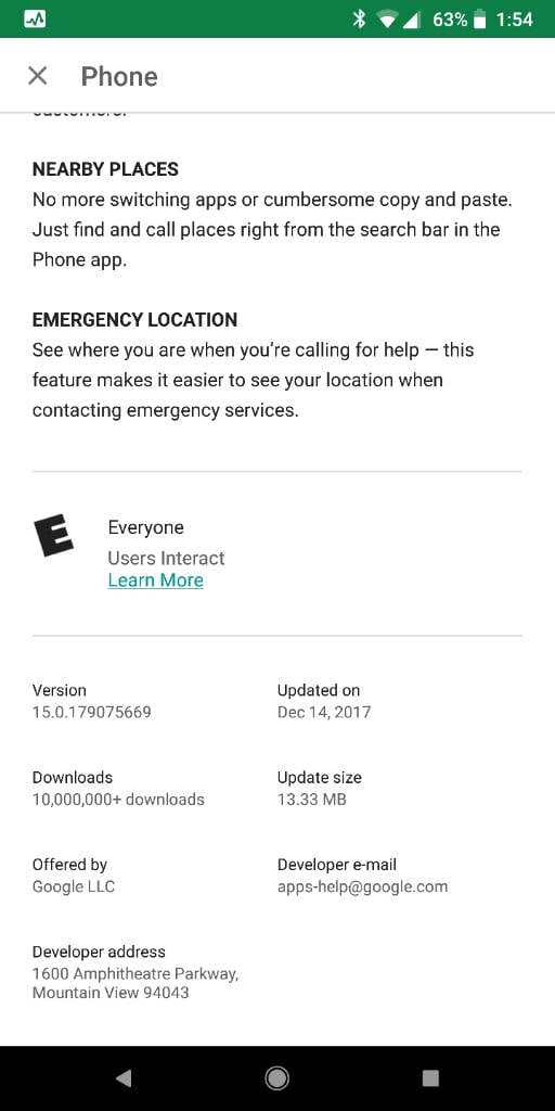

Me too. This works for now. “uninstall updates “ from the app Play Store Phone app. That worked for me. I have not updated it since and no issues. I’ll wait for the next app update to try again..

Actually, this is an interesting thought but I took it a different route. I uninstalled the updates as @dsignori suggested and it seemed to fix it. I reinstalled the updates just to see if that might work, it did. I then realized there was one other difference - I had turned off my bluetooth headset when I returned home. I turned it back on and next test call resulted in a black screen! So, as a final test I connected another headset that can be used for phone calls (my Zolo Liberty+) and that also resulted in a blank screen on an incoming call.
Last test - uninstall the latest updates and try again with the headset connected. Result - I see the incoming call screen.
Bottom line - with a Bluetooth headset connected with the latest version of the dialer installed I do not get an incoming call display.

Google released an update to the Phone app on January 17. I just installed this update and the initial test indicates it seems to have resolved the issue of the screen not waking with a headset connected.

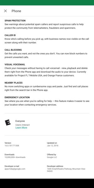

For whatever reason that update isn't showing up for me
I looked on the Play Store page and saw the update. I just checked my phone, the Play Store page shows the version on my phone as updated January 12.
Interesting. Do you happen to have the 'mystery software update' that was referenced in another thread? (Does your 'Build number' end in 016 [mystery software update] or 013 [original January update]?)
Still on .013...
