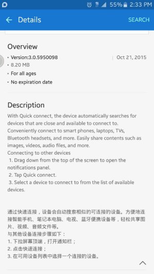

As mentioned above, the new offering is Quick Connect (which is not terribly quick at all). I haven't yet tried connecting from the Tab S2, but maybe I will.

I haven't tried Quick Connect with the TV or a player but I have transferred files from a Note 4 to a Note 5 and it was super quick for me.
Yup.. I never used Quick Connect until I got my Note 5 and transferred a lot of stuff from my Note 4. The Note 4 is the first time I remember noticing "Quick Connect".
For what it's worth, my comment about Quick Connect not being Quick was aimed at how quickly the devices will actually connect to one another. For data transfer, it moves the data along pretty nicely (once you're actually connected).
I think it connected for me in less than a minute, but don't know for sure. I haven't used it since Note 5 launch day.
