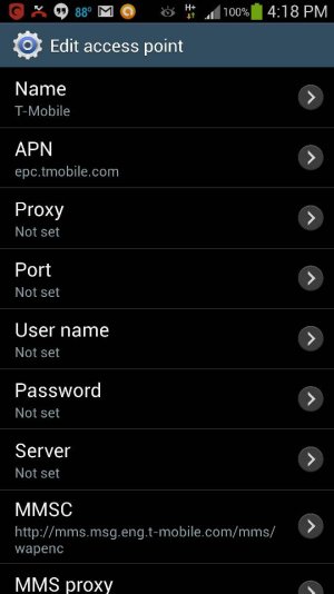

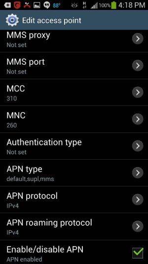

The APN settings from that xda thread are for T-Mobile's LTE network. These are the T-Mobile APN settings that I use with my Verizon GS4. May be worth trying these settings to see if it makes a difference.
