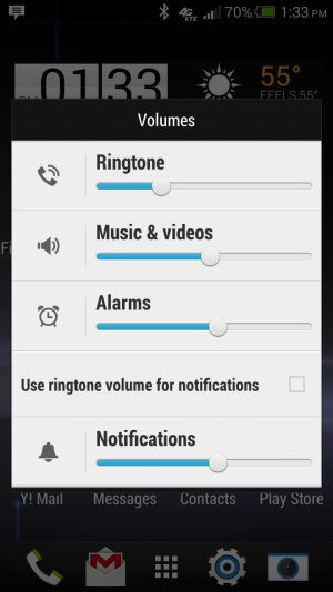

Push the volume rocker up or down, then press the settings icon on the right and the attached screen comes upScreenshot_2013-11-14-13-33-56.jpg giving you the ability to separate one volume from another. I have HTC One running 4.4. I don't know whether that function is specific to my HTC One or if it applies to the Android OS...
