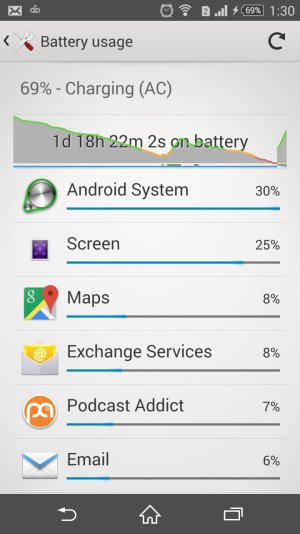

I'm having a similar issue. Except for me, my battery is draining hugely WHILE IN AIRPLANE MODE! 2 nights ago went to sleep in airplane mode with 59%, woke up with 22%. Last night went to sleep in airplane mode with 29%, woke up and the phone was completely out of juice. The battery usage report shows "Android System" is the hog here, while in the past, before I had this problem, "Screen On Time" was always the biggest hog. Not sure what the heck happened.
If there is larger chunks for Blue awake bars more than the screen on time, then you have an app that is keeping your phone awake while the screen is off. This is what is causing the battery drain.
Have you checked what is high on the battery usage screen?
Nope... it's really strange. Nothing that I can see is doing that. With heavy use from 7am to 11pm, battery went from full charge to 60%. Then set it to airplane mode at bed time, wake up, and it's dead again.
Same here but my phone is 4 months already. I sleep at night with 31% but I woke up this morning drained. Even with stamina mode is turned on my battery drains fast mostly at night. This happen twice
