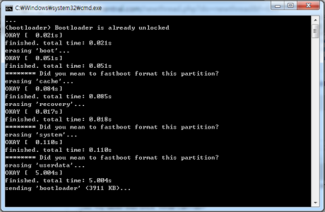

I wanted to install stock rom, So I reboot fastboot, and connected device, and installed file.
However, When flashing bootloader, it does not proceed any more.
So, my tablet was brick. What can I do?

Can I ask how you were going about flashing the factory images? Did you use a toolkit or doing it manually via command prompt and fastboot?

I just downloaded factory image file in google, and used flash-all.bat.
I have used this, But suddenly not working.
