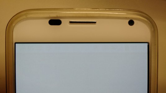

It's an AMOLED issue in general. It's just the nature of the beast. I have a 2013 Moto X I've had for about 6-ish months now, and while the burn-in is in no way visible during normal use, it's apparent that it is happening when I run screen tests that make the screen entirely white (you can see some areas are dimmer, particularly the notifications that are usually on screen).
Here is a photo of my Moto X 2013 screen taken from my Moto X 2014. I'm running a "screen test" that makes the screen entirely white. The burn-in is very subtle so far and in no way affects my use of the device.
On my Moto X 2014, there is no sign of it happening yet, but I've only been using that for a couple of weeks now.
The more bright colors you show on your screen, the more the screen is going to burn in. Lollipop and the new bright Material design might be the worst possible thing to happen to an AMOLED screen. But they'll last for at least a couple of years in general with no significant changes to image quality (though as they slowly get dimmer with use, contrast and specifically daylight visibility may get subtly worse).
And if you run with a specific bright image on the screen a lot, you'll start to see additional burn-in where that image is - so bright wallpapers are not ideal on an AMOLED if you tend to leave your phone on the home screen a lot.

While the Samsung panels are probably of better quality, to put things in perspective a bit I looked up my order. I got my Moto X 2013 on January 25 of this year. It has been my daily driver, for both corporate email and personal use (heavy Ingress player, so lots of screen-on) from then until November 25th when my new Moto X came in.
Given that the notification toolbar is always bright-white-on-black when the screen is on, the very subtle burn-in you see in my photograph above is the result of 10 months of very heavy use at the highest contrast ratios possible. The screen has been on at least 5 hours a day, sometimes more than that, for the entire time. And I don't skimp on the brightness - I bought an AMOLED screen because I wanted bold beautiful saturation.
So for even a fairly heavy user like me, after two years - maybe the screen isn't quite as bold and bright and maybe it's not as visible in full sun - but I'd be willing to bet the accumulated damage would be barely noticeable. Doubling the amount of "dimness" you see in my photo would still leave you with a quite functional screen.
