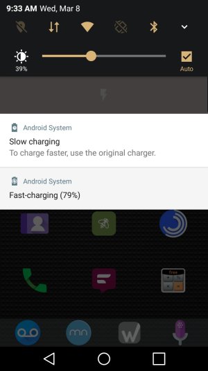

Usually I do not see this with the charging indications.....usually the indication in notification panel showing the "slow charging please use original charger" blah blah blah......and then I just unplug the power cable and plug it back in resulting in a normal "fast charging" indication.
This happens with with almost all my chargers:
Motorola turbo charger 2.0 QC 18W (model SPN5864A)
Tronsmart QC 3.0 (model WC1T)
LG USB 3A USB C TO C (model MCS-N04WR)
Im not sure if it is LG software or Nougat that is unable to figure out what charge mode the phone may be in.
My LG G5 has done that only once since I've owned it... all I did was push the USB-C plug into the phone jack till it snapped, and problem solved! It appeared that it was not set all the way in when I first plugged the cable to the phone.
Forget about the charge MODE. What about the charge %? After directlytr chargimg with phone turned off, I turned on & its at 94&; 43 minutes later, I'm already on the road trip, miles from home. Turn on phone: 50%.
Yesterday it did the ss
