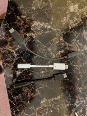

I have tried three different dongles with the Pixel 2 XL. One form HTC, the PH-1, and the Pixel 2's dongle. By far the HTC dongle had the best sound, next the PH-1's dongle, and last the Pixel's dongle.
I believe the dongle from the HTC U11 has a DAC built into it. I'm surprised it works if thats what you are using. Is it much louder?
I was surprised the HTC's dongle work also. But after reading a post on XDA I decided to give it a try. What surprised me more is that all three dongles works in both the PH-1 and the Pixel 2 XL.

All three have DACs in them and therefore should work in any USB-C port for audio, including a computer if the correct driver exists. The only one I'm aware of that doesn't is the one from Moto since it's pass-through only and needs to tie directly into a supported Qualcomm SoC DAC.
