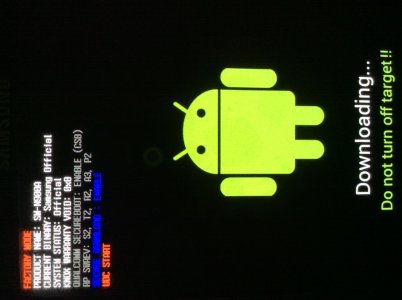

Downloading... Do not turn off target!!

Pushing the power button, down/up button, and home button restarted my phone and got it out of the Downloading....do not turn off target screen. Thank you so much.:)
My samsung tab 4 randomly popped up the same screen, Android logo and saying downloading do not turn off target. I was in panic mode, because it wouldn't do anything, so I saw this forum and saw where someone said to hit the down volume+power+home all at the same time and it resolved the issue, and restarted my tablet. Thank you for the help!
My galaxy tab 3 won't do anything. It just keeps reading downloading do not turn off target. Please what does this mean and how do I fix it?

I turned my phone off a week or so but when I came back to it.I saw it was in this state
Downloading do not turn off target
It has been in this limbo state a few hours
I have read the advice on this forum
Is it safe to force the power off, take out the battery and reboot?I worry there is No Operating system in this current state!
