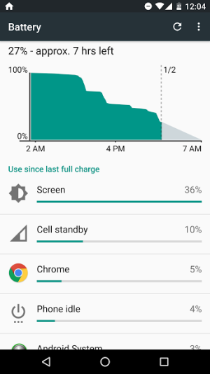

Heres a screenshot of last night. It actually does seem that my cell standby might be the culprit. I'm going to have to try airplane mode or something tonight and see if that helps. I'm noticing, at this moment actually, that as I'm sitting still in my bed my cell signal drops from 4/5 to 1/5 and back up to 4/5 pretty frequently (as you can coincidentally see in the screenshot).
Do you think there are any cell settings I can try to limit how much it searches? Airplane mode will be helpful to figure out if my cell signal is the issue but it can't really be a permanent fix for me.

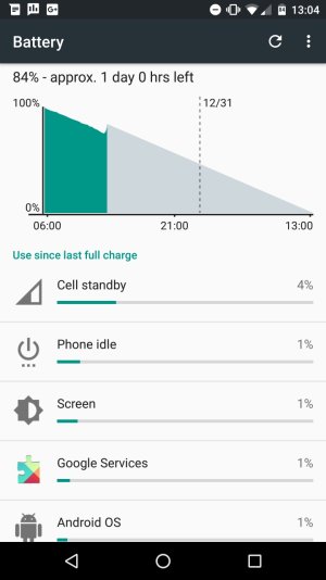

I think you are onto something about Facebook being the culprit. I typically charge my device overnight, but I've kept it off the charger several times overnight. I also only lost ~4%. I also kept on both WiFi and cellular. I don't have anything from Facebook installed.
Just as a trial, I charged my Pure to 100% *before* bedtime for a change, turned it face down and un-plugged and went to sleep.
In 8 hours it had used 2%.
While I watched a whole lotta college bowl games I didn't use it often thru the day. Curve is very flat during several periods.
