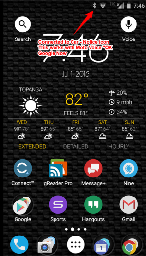

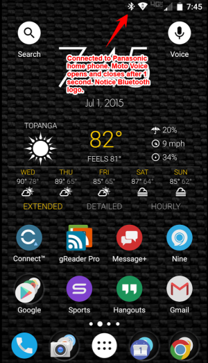

I ran some tests and noticed that this is a problem only when attached to a certain Bluetooth connection. Specifically, my home phone (Panasonic). The Bluetooth icon is also different. See the photos.
This is attached to the home phone:
This is attached to my car.

I tried things that were suggested. I found that either turning off Bluetooth or disconnecting my Panasonic home phone allowed Moto voice to work. Obviously that's not a permanent solution. I disabled, enabled, etc. Moto voice but it persisted.
The fix? In Moto, then voice, I checked the Audio Troubleshooting option. Fixed now.
