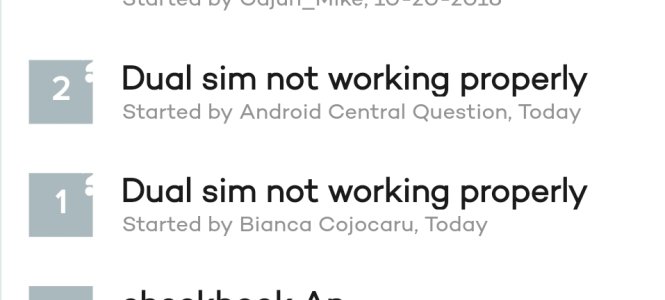

Looks like its working properly to me, lol jk
