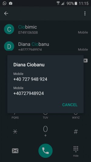

Hello everyone,
I am running a stock rom on my GS6 and since yesterday, when I had to call someone I noticed that I have duplicate phone numbers for each contact, but only when I type a contact's name using the T9 function of dialer. If I go to contacts, everything is fine.
I noticed that the issue is solved after uninstalling whatsapp. When I reinstalled whatsapp from the play store, it installed version 2.12.176, but I instantly got the update for 2.12.242 which was the version I had before. The issue came back after 30 minutes of use...
Any help would be greatly appreciated.

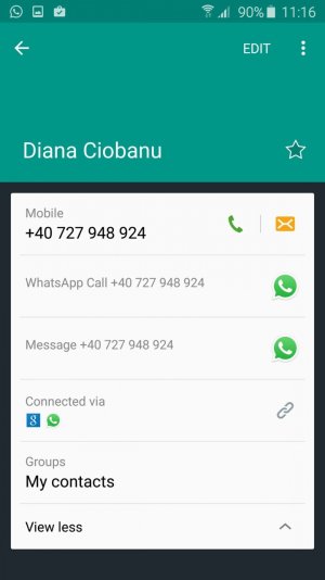

Okey, so I had the exact same problem and I think I might have found a way to fix this. The problem is it's contact by contact and not bulk.
1. Go to your contacts in your S6. Search for a contact that you know have duplicate numbers in the dialer.
2. You will now see that there is just one number added to the contact.
3. Click the "show more" link in the bottom of the contact card (above your recent activity)
4. This expanded view now shows you more contact info. Look for the "Connected by" field with a link symbol on the right.
5. This field will show you what services link contact info to this contact. Click it and press the "-" by the connected app to split it from this contact.
6. Now if you search for this contact again you will find two contacts. The original one and the one you just broke free.
7. Click the unwanted one and press "more" in the top right and select "delete". It will warn you that you cant delete read only stuff but proceed anyway.
8. Voila! Now you don't have duplicate numbers in your dialer.
As I said this is a bit tedious, but it works. I have done it to my most frequent contacts and thats good enough for now. There is an option in the contact app where you can choose what sources to show in your contacts but that doesn't seem to work or doesn't apply to the dialer.
Hope this helps

Hey bro, thanks a ton your solution worked out perfectly. Although it needs to be done individually, I suppose we can do it for the most frequently used contacts.
I made the mistake of synchronizing contacts from many places: WhatsApp, emails, etc. Now unchecked Contracts synchronization from all those.
Thanks a lot for pointing this out! :D
