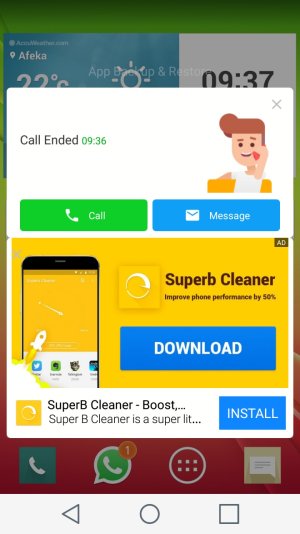

Each time, when an incoming call ends, my LG G2 shows the following window:
How can I get rid of this nuisance?
You've probably downloaded an app that's bombing you with these ads. Starting with the app you've most recently installed and working backward, uninstall until the ads go away.

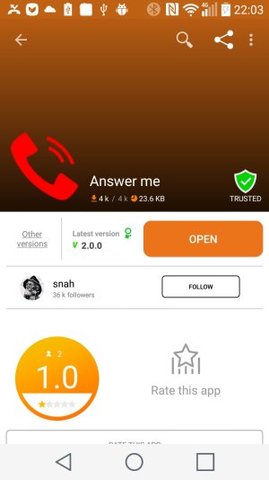

Looks like the application "Answer Me" is the culprit.
There doesn't seem to be a direct way to uninstall it.
Any suggestions?
That definitely doesn't look like a Google Play Store app, so you should try to remove it. Did you enable app installations from unknown sources?
Open Settings->Apps, then scroll through the list until you find Answer me.
Tap "Force Stop," then "Uninstall."
If that doesn't solve the problem, you may need to factory reset the phone.
Well, Imanaged to uninstall the "Answer Me" application, but unfortunately, it's a legitimate LG G2 application, and it's not the source of my problem.
I've uninstalled recently installed applications, but failed to locate the source of this nuisance.
Could you suggest an alternative path?
I’d keep removing apps until you find what caused it. Otherwise, reset to factory defaults (but make sure you’ve backed up anything you can’t lose first).
Let's look at this a different way....it's an ad that shows up after ending a call. Are you using the stock LG phone application? If you are, you can try to find an alternative. I'm not sure if Google phone is available where you are.
